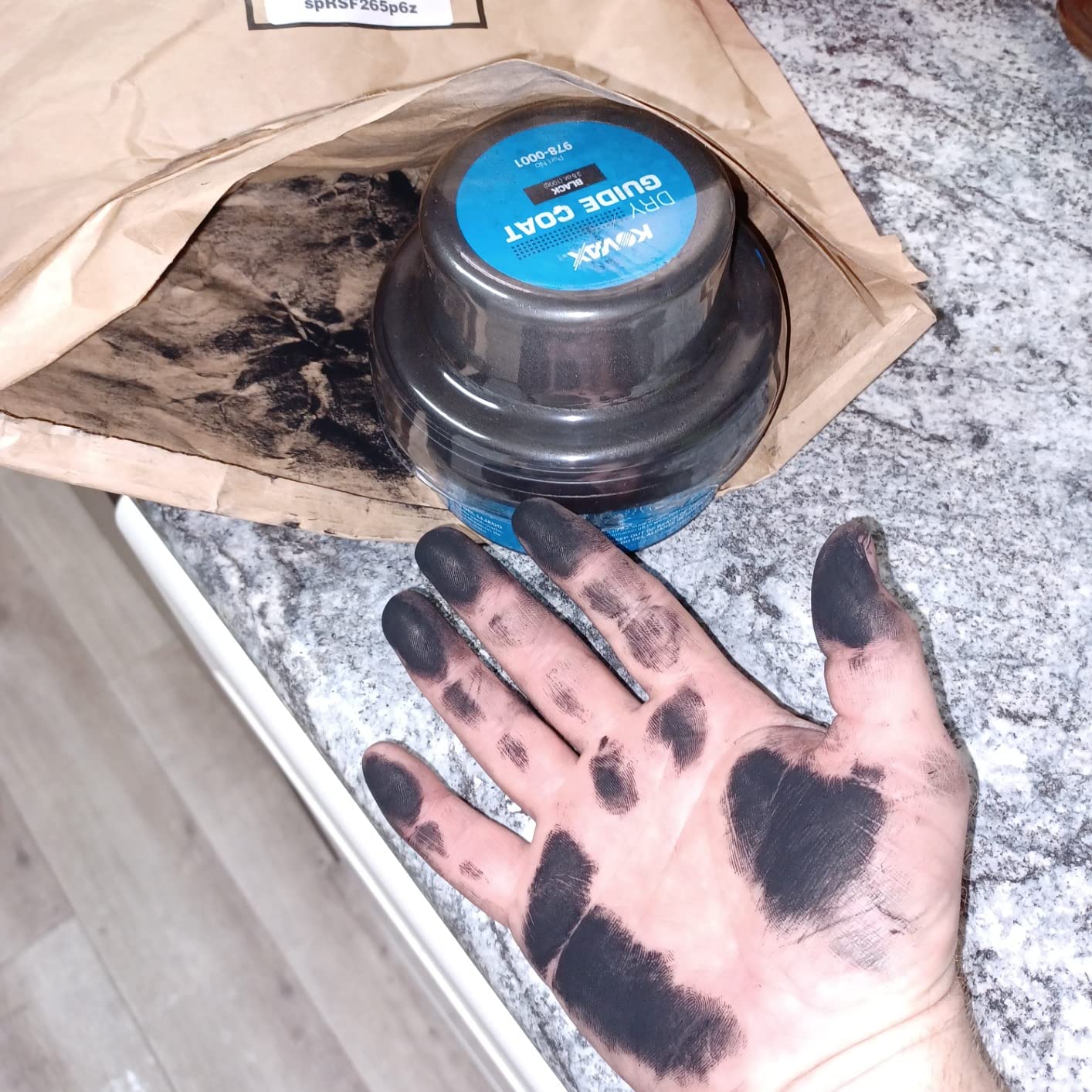

All done with spraying on the ziricote 00. Excited to level and buff it this week.
https://youtube.com/shorts/PS3PSXuS-RM? ... Bjfffqqu1N
Also, anyone else try this stuff? Im going to try it out this week.
Brad
Sent from my iPhone using Tapatalk Pro
Brad
No, but I see there are others manufacturing similar products, Mirka for example.
Brad
I had read about this for NC lacquer on another forum. I've used guide coats on motorcycle tins and wondered what they were using on guitar lacquer.
This guy posted on amazon that he didn't like it :o

Very nice demo! How would you rate your orange Kovex GC on a scale of 1-10?
Does it show up on dark wood too?

The Guide Coat looks interesting. How fine of a grit on a sanded surface can it be used on? Any concerns about a fine powder like that getting places on the bench or in the shop where you wouldn't want it? Or lungs.
